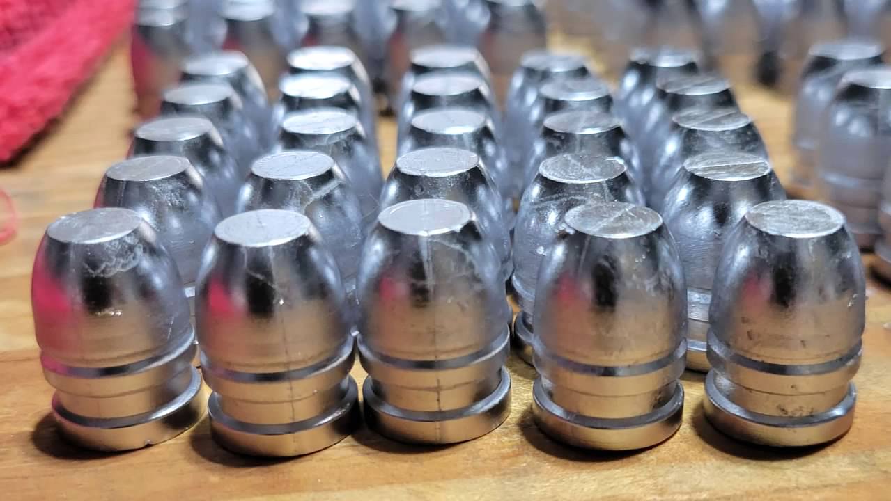

« Reply #294 on: March 03, 2024, 09:51:20 AM »
Cast up some Big 50 Bullets yesterday.
King Medallion

« Reply #295 on: March 11, 2024, 08:28:34 AM »
King
Those look real nice! Is that the Accurate mold?
DB
Offline King Medallion
  • Posts: 1198
  • SASS #: 14753
  • Likes Given: 168
Re: Loading Data for the 50/95WCF
« Reply #296 on: March 11, 2024, 09:06:36 AM »
Yes Sir!
