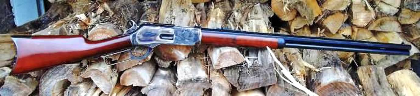

look at the history of (toggle link action) development - the 76 is an obvious endpoint
1) the volcanic - short slick and quick but inneffective ammo - propellent charge in the projectile
2) the henry/66 - stretch the action some - better ammo - the 44 rimfire about as good as it got in its day
3) the 1873 - stretch it a bit more - better ammo again - proper reloadable centre fire ammo - the fact that the 1873 is the premier race gun in cowboy action today speaks large of the effectiveness of this action design
4) the 1876 - stretched that thing as far as it could go - we wanna join the big boys - just like today - military contracts is where the money is - despite much writing to the contrary they did in fact duplicate military ballistics with the 45/75 - at the point where the military was backloading the 45/70 to make it a little more shootable the 45/75 had a 350 grain boolit sitting on 75 grains of powder, winchester also marketed a long range load - 450 grain PP boolit over 90 grains of powder for single loading in the 76 - at least up to specs with the military 500 grain load in the 45/70
where would Winchester have gone? without Browning is an interesting point - no answer cuz it went where it went at the time
I have a replica of the 76 and 86 - limit both to blackowder rounds and if  had to take one into a fight - I proly pick the 76
the target I posted is a Uberti dont think they missed the mark at all with that one ! I was told these are Pedersoli barells - it looks like one - shoots like one
this is a 45/75 - 20" twist barrel - your comments (Galloway) are likely more pertinent to the other calibres - particularly 45/60 - 40/60 - those two I always considered afterthoughts, a marketing excercise ....the 50/95 in its day would have had few peers - a niche gun for sure but up close on soft skinned angry things second only to a good English Double.
