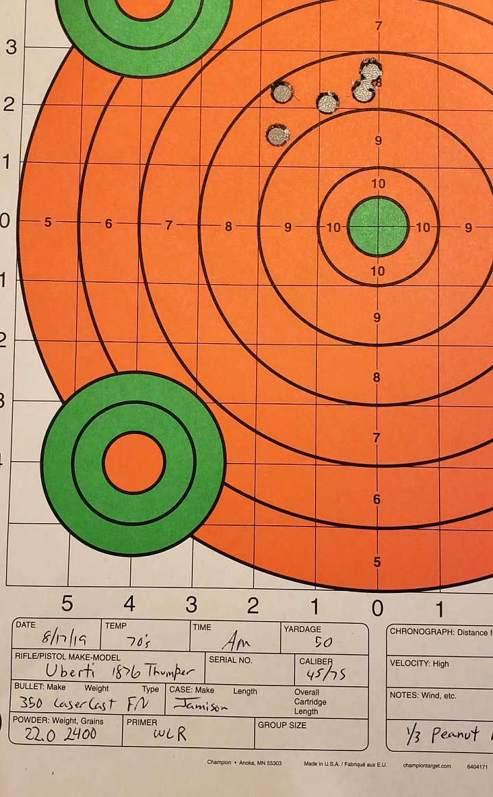

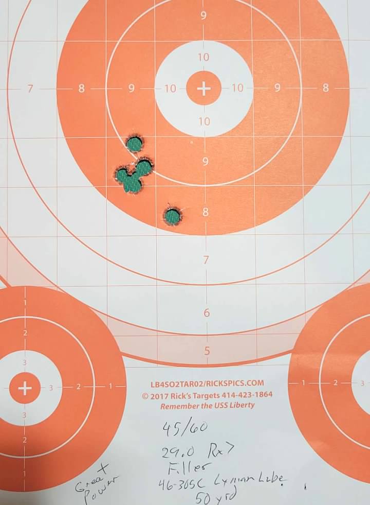

I haven't really done any long distance shooting with mine, per say. I do my test loads at 50 yard, till I find a great one, then work on that. Maybe I'm too finicky and expect more from my rifles. Or maybe I'm just not a great shot, I don't know. Anyway, I'll post my best of what I have.
50/95 Presidio
45/60 Shorty
45/75 Uberti Chamber I was able to whack a gong at 150 with regularity a few years ago
King Medallion
