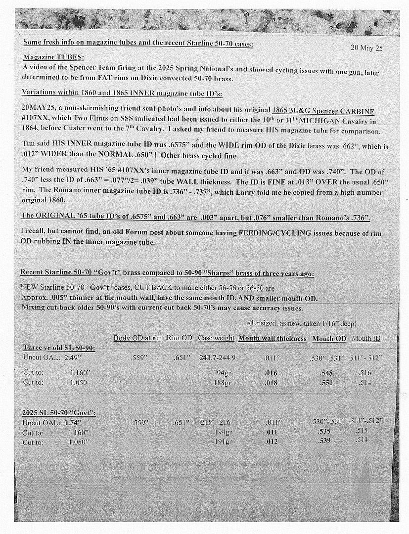

The 500 Starline 50-70 "GOVT", NOT "SHARPS" cases arrived after a two year wait. I cut a few to 1.60" and 1.05" and measured them for comparison with the Sharps ones I'd used before Covid.
Found minor, but possibly noteworthy differences.
The rim OD's and body OD just above the rim are identical.
There are slight differences in the wall thickness, mouth ID/OD of 56-50/56-56 cases cut down from the parent "SHARPS" vs "GOVT" ones.  The cut down Sharps case has slightly thicker case mouth section wall and wider cut down mouth OD than the GOVT one.

Two Flints inserted a page from my files to help with trimmed case dimensions.  Converting the photo "file" was a lot of work.  I try not to overdo his willingness. Thanks, Two Flints.

Apologies for fuzziness. Two Flints can work only so many factors - not his fault. Kevin
                                   Photo Added by Two Flints
