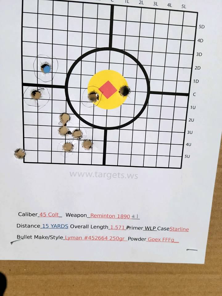

Firsts off I'll say that before I even shot the gun, I sent the cylinders off to get reamed to .4525, as I couldn't get .451 bullets thu the throats. Sunday afternoon took the #1 1890 out for 1sst shooting session. I don't have a pic of the 1st target, will get that for you tomorrow. I did think enuff to take a pic of the Black Powder loads.
The circled holes are the 1st 5 shots, the nice little uncircled cluster is the 2nd cylinder full. It has potential! But those 2 cylinders were all it took to binder her up good.  (forgot my Balisol)

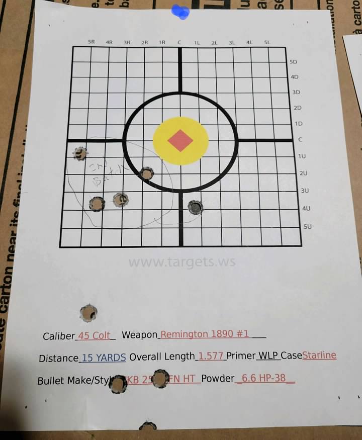

Unfortunately, what I learned on my 1st try with smokeless loads was that I had to aim at the top of the paper target! It shot that low! Granted it wasn't a great load, basically a light load of HP-38 just to get rid of the powder as it doesn't work well in anything I have to shoot, and the bullets were 200 grainers. The 250 grain bullets raised up about half, but still a disappointing POI.

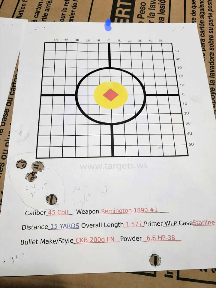

OK, I'll try not to babble on to much. The 1st pic is with a 200 gr bullet aimed at the bullseye at 15 yards. Only 1 hit on the target at the bottom.
The next cluster is aiming at the little blue dot at the top of the target.
Then we go to a 250g coated bullet, 1st aiming at the bullseye, then the circled group aimed at the blue dot at top of target.

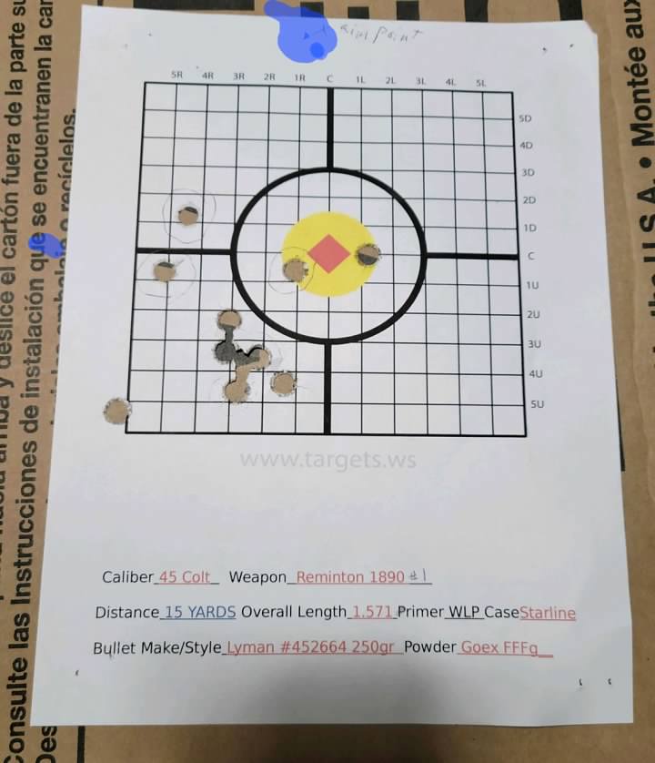

Last is a home cast 250g bullet, Goex FFF SPG lubed, aiming at top of target. Likes Black Powder, but could only get 2 cylinders before fouling bound her up.
Lots more load development to do before filing the sights down.
