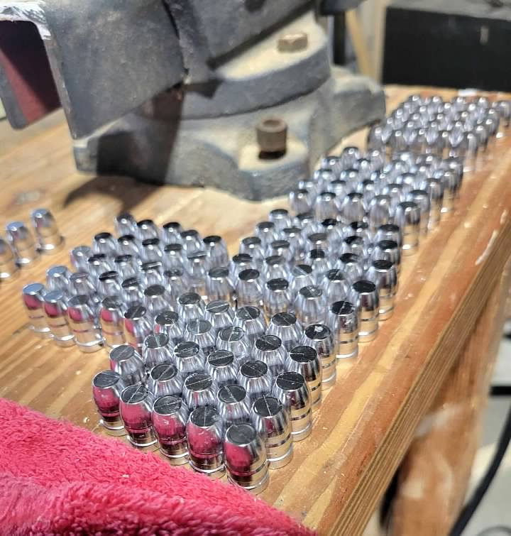

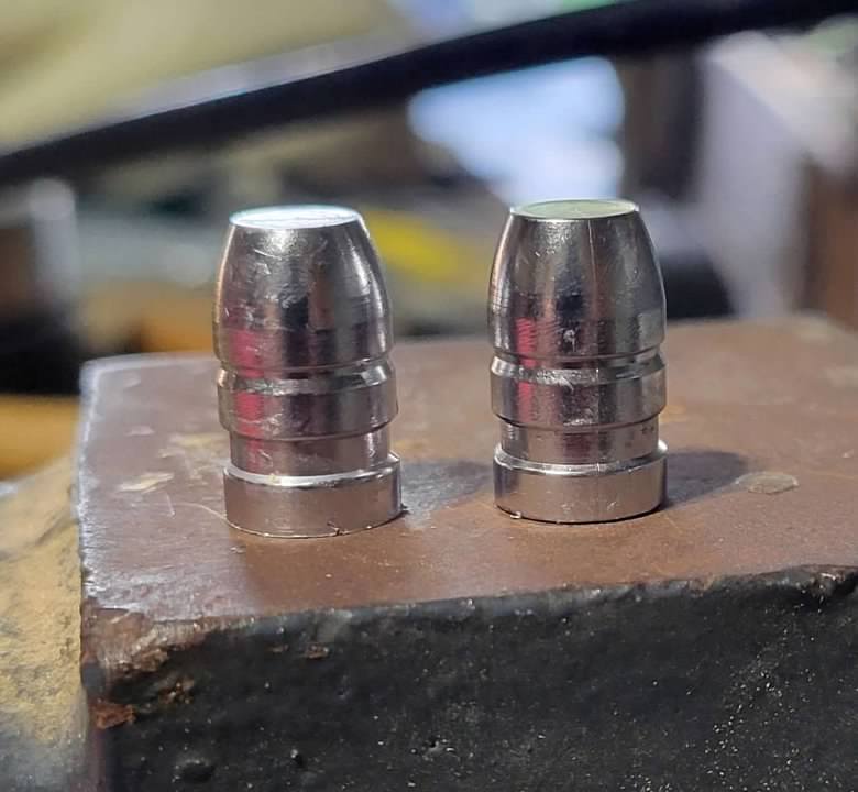

Cast up 131 40/60 bullets from the new Accurate mold. Average weight is 224, size right t .407. I cast with 20.1 lead, cuz that what I read was good to use for this kind of bullet. Taking the Big 50 and 45/60 out today for shooting!

Recently got a brass Accurate mold for my 41 Mag. Made some boolits the other day and they dropped average .407-.408. Rather disappointed. The alloy is 1:25 from Rotometal. It dawned on me this morning I might be able to use them for the 40-60. It's a SWC boolit. Certainly won't be any good for 41 Mag.
