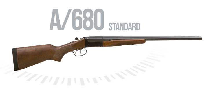

I am waiting for a new Boito s/s Coach Gun and preparing myself for some tuning. I have searched the internet for ways to polish the chamber for easy ejecting of the empty shell, and there are so many suggestions.
Anyone in this forum who knows a good method that works, and can be done at home?
