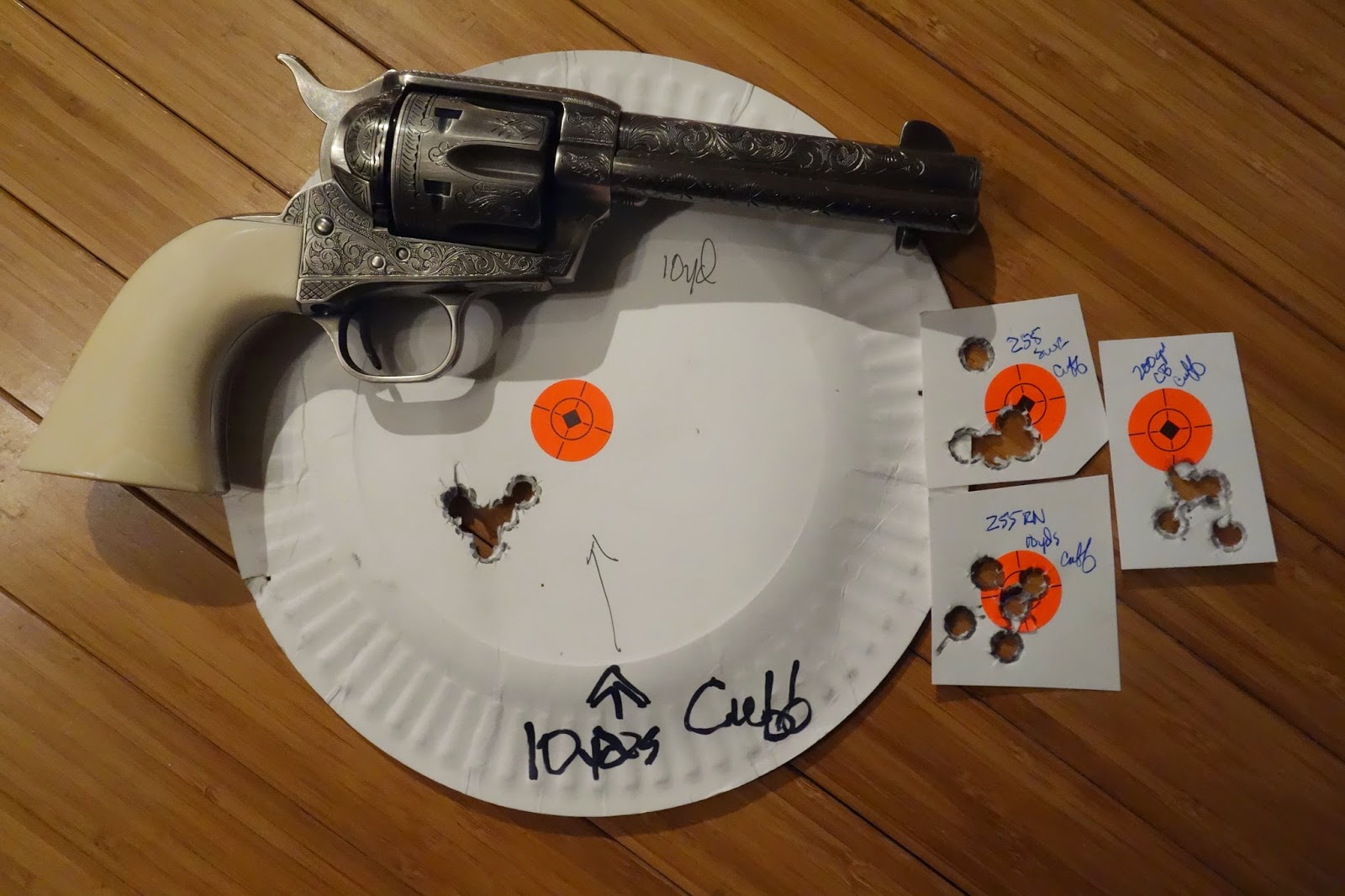

Here is a typical 3rd Gen Colt test target (I've done losts of them) before and after smithing and turning the barrel....in general they (Colt's) suck by comparison without a little or a lot of work to get them to shoot POA.

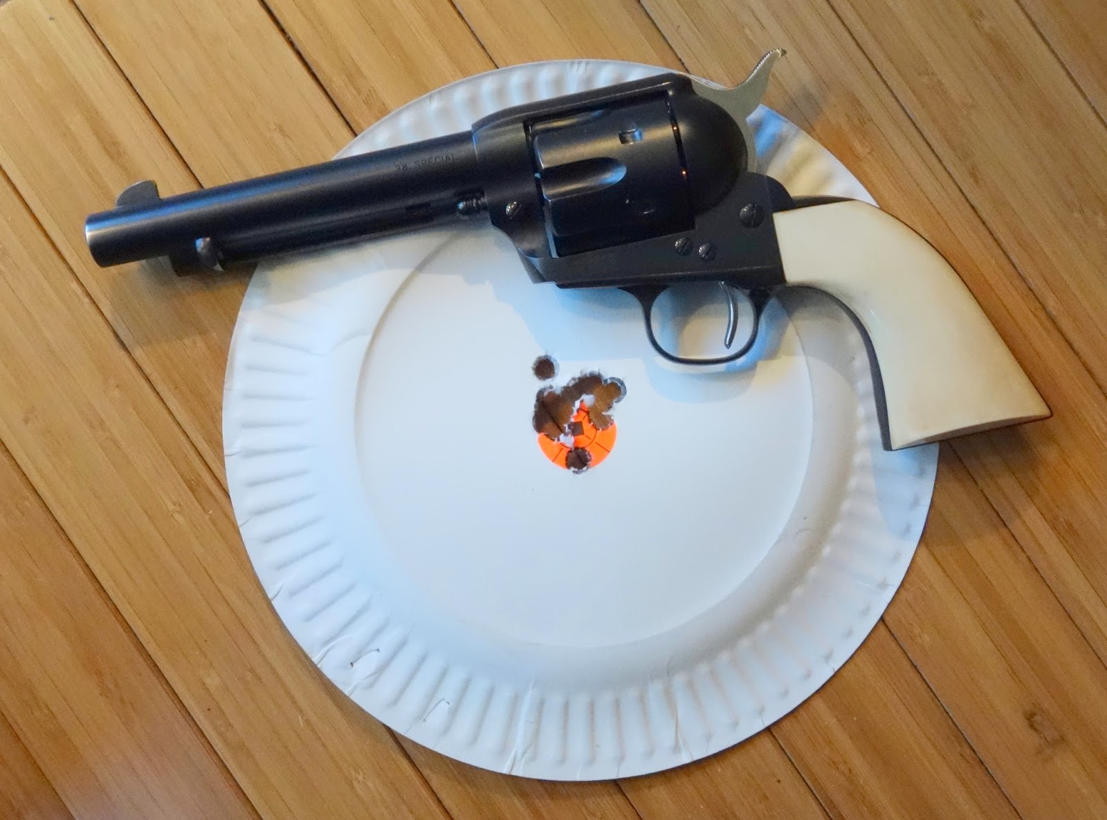

Here is  the 2nd gun in that pair which wasn't any better.  The before and after shots make it clear enough what a Colt is capable of and how they generally arrive from the Colt's factory.
Also worth noting in the last picture there are targets from 2 different bullet weights and 3 different bullets shapes  pictured.  255 round nose, 255 SWC and a 200 rounds nose.  Even @ 10 yards you can see some difference in POA/POI.  But  it isn't anywhere near as drastic as some would have you believe.  Same in 9mm, 38 Special, 44 Special, 10mm, .40 and 45acp as well.  Different bullet weights generally just string the rounds vertically...not as drastic in the changes for windage in my experience.   The extemes like a 90gr 9mm and a 147gr 9mm will have a bigger difference in POA/POI.  Just as a 165 and a 255 in .45 Colt will give you a big change on  POA/POI.   If you aren't shooting bullseye matches on paper or small game it is likely not to matter too much.  20" gong in SASS at 15 yards isn't likely to be missed even with the worst SSA I have seen if the sights were on target when the trigger was pulled ;)
